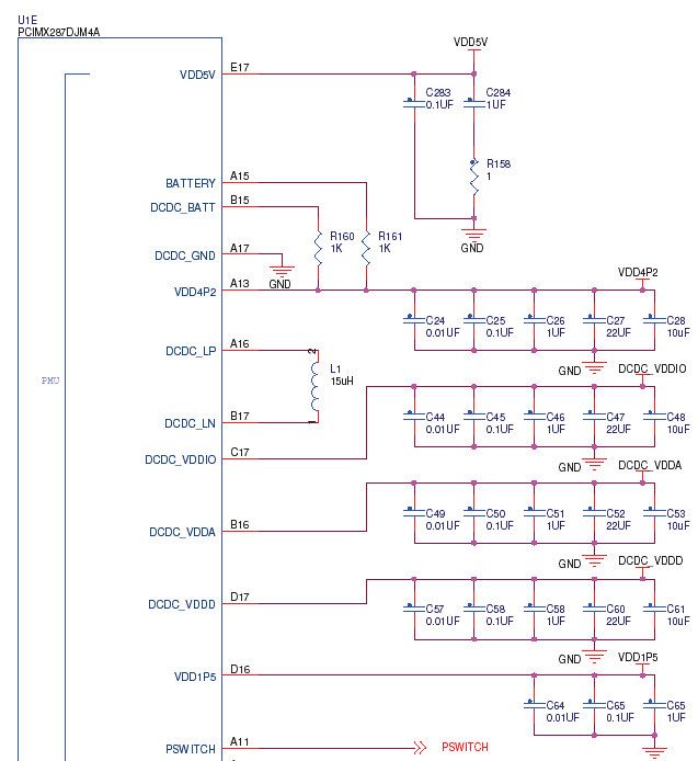

pt
Senior Contributor I
Hi igorpadykov
I am using ELPIDA E116AEBD DDR2 .
I have tested DDR2 using memory test code (mem_test).
It works fine.
At first it just displayed 'simsimsimsim' only.
Problem at power_prep section.
So I changed the value of HW_POWER_5VCTRL (clear the value of bit 0,  i.e., disable DCDC).

igorpadykov
Hi Pt
do you mean that you do not use DC-DC at all,
even with VDD4P2 ?
~igor
5,552 Views
pt
Hi igorpadykov,
I am using DCDC. But the code worked when I disable that bit.
I think when  switch from linear regulator to DCDC, there is some power issue.
Is there any problem in my circuit design?
Pt
5,552 Views
igorpadykov
you should find reason why ddr test does not work with DCDC (probably it is erratum 5837),
may be for that reason linux is not working too.
There are many ways to debug it, one - use OBDS (run it with jtag)
"IMX_OBDS  : On-Board Diagnostic Suit for the i.MX28"
http://www.freescale.com/webapp/sps/site/prod_summary.jsp?code=MCIMX28EVKJ&fpsp=1&tab=Design_Tools_T...
5,552 Views
pt
Hi igorpadykov
     Thank you.
     The issue was due to brownout.
Pt
