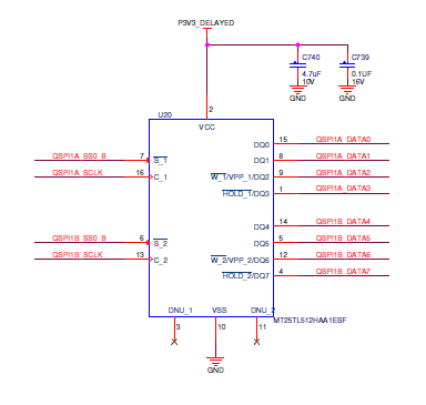

I'm using imx8m custom board, linux 4.9.51 ga release.
I'm trying to implement QSPI_A and QSPI_B in imx8m platform. I'm able to add QSPI_A(alone) successfully. If I add both QSPI_A and B, the board hangs. If I try to add QSPI_B alone by disabling A, I get the below messages:
# dmesg | grep -i spi
 fsl-quadspi 30bb0000.qspi: unrecognized JEDEC id bytes: 00, 00, 00
 fsl-quadspi 30bb0000.qspi: Freescale QuadSPI probe failed
 fsl-quadspi: probe of 30bb0000.qspi failed with error -2
Following is the dts node and pin controls I'm using.

Is this correct? There is no clock when I probe. Is there anything which is needed to be added to enable QSPI_B apart from the dts?

jimmychan
Did you use symmetric NOR chips?
for example:
If two chips(or two planes in one die) are symmetric, the driver should work fine, please follow the i.MX6SX dtb settings below:
