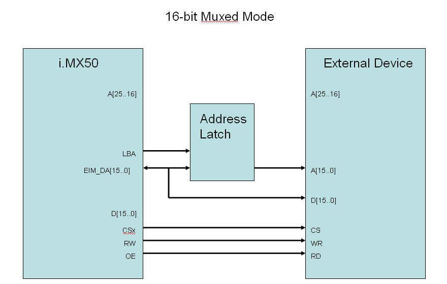

Hello Champs,
A customer is asking for schematics or diagrams which use a 16-bit multiplexed NOR Flash connected to EIM.
I found some of SPI NOR Flash cases but none of EIM.
Please introduce if there is any.
Nori Shinozaki

igorpadykov
Hi Nori
I think below diagram may be useful
igor
