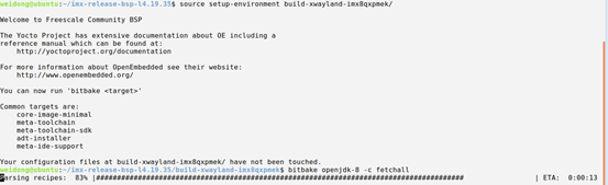

3. Build openjdk-8
# cd ~/imx-release-bsp
# source setup-environment build-wayland
#bitbake openjdk-8 -c fetchall
         Fetch all packages related to openjdk-8.

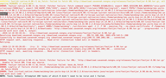

         During downloading packages, you may encounter errors like the following.
(1)Fetch fastjar-0.98.tar.gz errors
         The error is caused by invalid web address, we can download it from another link, see below:
http://savannah.c3sl.ufpr.br/fastjar/fastjar-0.98.tar.gz
copy the link to firefox in Ubuntu platform, and it will be downloaded into ~/Downloads
# cd ~/imx-release-bsp/downloads
# cp ~/Downloads/ fastjar-0.98.tar.gz ./
# touch fastjar-0.98.tar.gz.done

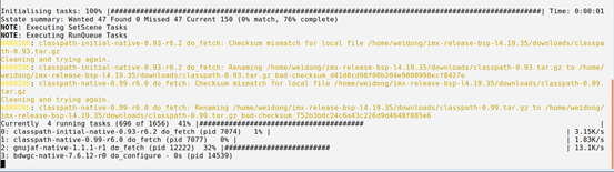

(2)Fetch “classpath-0.93.tar.gz” error
         Download it from : http://mirror.nbtelecom.com.br/gnu/classpath/classpath-0.93.tar.gz
And copy it to ~/imx-release-bsp/downloads, and create a file named classpath-0.93.tar.gz.done in the directory.

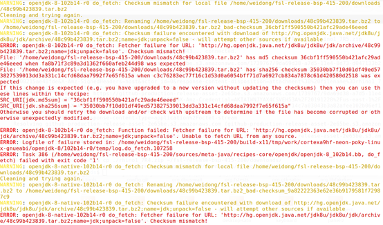

(3) 8 files with tar.bz2 (hotspot-Java jvm)
         These similar errors are very likely to be encountered.
         These errors are caused by the bad network environment. You can download these packages manually. These are Java virtual machine source packages, i.e. hotspot JVM
[Solution]
# mkdir ~/temp
# cd temp
# wget http://www.multitech.net/mlinux/sources/56b133772ec1.tar.bz2
# wget http://www.multitech.net/mlinux/sources/ac29c9c1193a.tar.bz2
# wget http://www.multitech.net/mlinux/sources/1f032000ff4b.tar.bz2
# wget http://www.multitech.net/mlinux/sources/81f2d81a48d7.tar.bz2
# wget http://www.multitech.net/mlinux/sources/0549bf2f507d.tar.bz2
# wget http://www.multitech.net/mlinux/sources/0948e61a3722.tar.bz2
# wget http://www.multitech.net/mlinux/sources/48c99b423839.tar.bz2
# wget http://www.multitech.net/mlinux/sources/bf0932d3e0f8.tar.bz2
         Then create .tar.bz2.done files for each package via touch command

         Like below:
         Then copy these files to ~/ fsl-release-bsp/downloads/

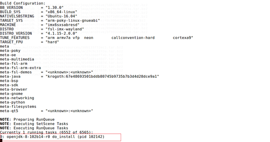

# bitbake openjdk-8 -c compile
         After openjdk compilation, you will be prompted as follows:
         At last , install openjdk-8 to images
# bitbake fsl-image-qt5

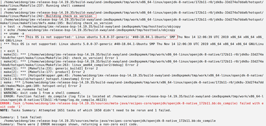

# cd ~/imx-release-bsp-l4.19.35/build-xwayland-imx8qxpmek
# bitbake openjdk-8 -c fetch

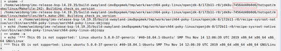

[Errors]
[Solution]
# gedit ./ tmp/work/x86_64-linux/openjdk-8-native/172b11-r0/jdk8u-33d274a7dda0/hotspot/make/linux/Makefile
Comment the following lines:
check_os_version:
#ifeq ($(DISABLE_HOTSPOT_OS_VERSION_CHECK)$(EMPTY_IF_NOT_SUPPORTED),)
#       $(QUIETLY) >&2 echo "*** This OS is not supported:" `uname -a`; exit 1;
#endif
         Then continue

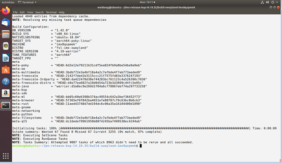

[comment]
         Probably similar errors will be encountered during compiling other packages, we can use the same way like above to solve it, see bellow, please!
Done:
         At last, install openjdk-8 to images.
# bitbake imx-image-full
         Installation is done.
