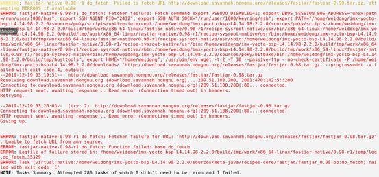

         During downloading packages, you may encounter errors like the following.
(1)Fetch fastjar-0.98.tar.gz errors
         The error is caused by invalid web address, we can download it from another link, see below:
http://savannah.c3sl.ufpr.br/fastjar/fastjar-0.98.tar.gz
copy the link to firefox in Ubuntu platform, and it will be downloaded into ~/Downloads
# cd ~/imx-release-bsp/downloads
# cp ~/Downloads/ fastjar-0.98.tar.gz ./
# touch fastjar-0.98.tar.gz.done
