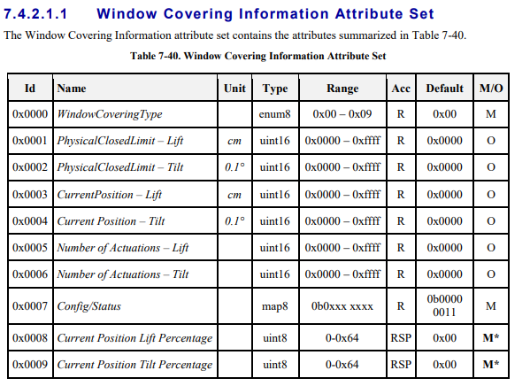

I am developing a smart curtain device. It use Window Covering Server Cluster.
But I see something wrong with this cluster in "ZigBee Cluster Library Specification".

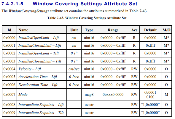

Window Covering Information Attribute Set and Window Covering Setting Attribute Set use the same attribute ID.
I think it should be:
Window Covering Information Attribute Set: 0x0000 - 0x000F
Window Covering Setting Attribute Set: 0x0010 - 0x001F
Can you explain it?

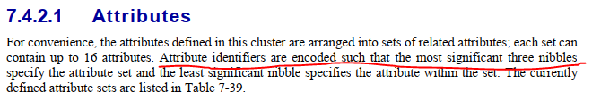

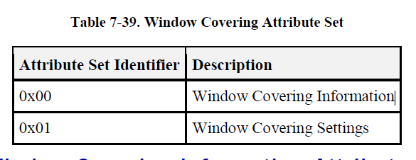

mario_castaneda
Hi Giau.
The server attributes for the Windows Covering has an Attribute Set depending on the description that you want, in this case.
Hope it helps.
Mario

nguyenanhgiau10
Hi mario_castaneda
I got it.
Thanks!
