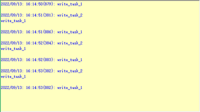

I have compared two project  "frdmkw38_freertos_mutex" and "frdmkw38_adv_ext_peripheral_freertos".
1. In "frdmkw38_freertos_mutex" I config configUSE_PREEMPTION == 1, and create same priority task like below:
The uart log looks like work well

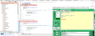

2. In "frdmkw38_adv_ext_peripheral_freertos" I config configUSE_PREEMPTION == 1, and create same priority task like below:
These two project I use the same method to create task but I got defferent result, where is the different?
It seems not useful to config "FreeRTOSConfig.h", isn't it?
