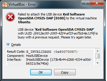

carlovalgocela
Hello
I get this error when i clicked USB devices -> Keil Software.
Already installed the Oracle_VM_VirtualBox_Extension_Pack-4.3.18-96516.
Any solution on this?
6,278 Views
alanball
That's a VB problem - VMWare has no such issues. I gave up trying to get VB to handle USB properly - it seems to be somewhat broken
6,278 Views
carlovalgocela
found a solution.
remove all the drivers and re install the VirtualUSB drivers
