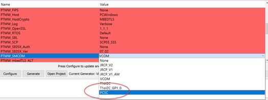

Hi @Kan_Li
I think you can add the following to some wiki page, because it is not just one little thing.
se05x middleware 4.5.0 on RPi4/Linux with USB reader (not T1oI2C)
1/ the reader have to be USB-CCID, and mine is using serialization:
lsusb
Bus 001 Device 003: ID 0403:6001 Future Technology Devices International, Ltd FT232 Serial (UART) IC
So, the reader above has to be replaced. You suggested Identiv uTrust 3700 F.
2/ Follow instructions for RPi T1oI2C until the folder simw-top_build/raspbian_native_se050_t1oi2c is created.
3/ Configure and Generate with cmake using -DPTMW_SMCOM=PCSC and other options as needed but do not build.
4/ Install drivers and headers and fix a bug in them:
apt-get install pcscd libpcsclite-dev
export C_INCLUDE_PATH=/usr/include/PCSC
 The export is workaround for inappropriate includes in dev headers (at least in a version I got across).
5/ Fix the middleware - edit file hostlib/hostLib/libCommon/CMakeFiles/smCom.dir/link.txt to end with "-lpthread -lpcsclite" instead of current "-lpthread -lpthread".
6/ now you can cmake --build .
7/ You will need to fix or remove C code in simw-top/demos/se05x/se05x_MultiThread/se05x_multithreaded_demo_task.c to cleanly finalize the build.

Hi @Kan_Li
Switching from I2C to PCSC produced this error on my raspberry Pi:
root@lite32g:~/simw-top_build/raspbian_native_se050_t1oi2c # cmake --build .
[  3%] Building C object hostlib/hostLib/libCommon/CMakeFiles/smCom.dir/smCom/smComPCSC.c.o
/root/simw-top/hostlib/hostLib/libCommon/smCom/smComPCSC.c:29:10: fatal error: PCSC/wintypes.h: No such file or directory
   29 | #include <PCSC/wintypes.h>
compilation terminated.
gmake[2]: *** [hostlib/hostLib/libCommon/CMakeFiles/smCom.dir/build.make:186: hostlib/hostLib/libCommon/CMakeFiles/smCom.dir/smCom/smComPCSC.c.o] Error 1
gmake[1]: *** [CMakeFiles/Makefile2:1823: hostlib/hostLib/libCommon/CMakeFiles/smCom.dir/all] Error 2
gmake: *** [Makefile:171: all] Error 2
I understand PCSC is characteristic for Windows? How do I make it work with Linux?
root@lite32g:~/simw-top_build/raspbian_native_se050_t1oi2c # uname -a
Linux lite32g 5.15.84-v7l+ #1613 SMP Thu Jan 5 12:01:26 GMT 2023 armv7l GNU/Linux

Hi @Kan_Li
As an update for my unsuccessful endeavor - I need PCSC to work off my raspberry Pi 4, which is Linux32, and I connect my USB reader to the Pi, and install the library:
libpcsclite-dev - Middleware to access a smart card using PC/SC (development files)
It has all the binding the middleware wants:
readelf -Ws /lib/arm-linux-gnueabihf/libpcsclite.so
    57: 00008144     8 OBJECT  GLOBAL DEFAULT   13 g_rgSCardRawPci
    58: 000047e4  1316 FUNC    GLOBAL DEFAULT   11 SCardEstablishContext
    59: 00003b10   516 FUNC    GLOBAL DEFAULT   11 SCardControl
    60: 00003da8    72 FUNC    GLOBAL DEFAULT   11 SCardSetAttrib
    61: 000040d4   512 FUNC    GLOBAL DEFAULT   11 SCardListReaders
    62: 0000254c   476 FUNC    GLOBAL DEFAULT   11 SCardDisconnect
    63: 00003df0   740 FUNC    GLOBAL DEFAULT   11 SCardTransmit
    64: 0000814c     8 OBJECT  GLOBAL DEFAULT   13 g_rgSCardT1Pci
    65: 00002e80  3216 FUNC    GLOBAL DEFAULT   11 SCardGetStatusChange
    66: 00008154     8 OBJECT  GLOBAL DEFAULT   13 g_rgSCardT0Pci
    67: 00004524   316 FUNC    GLOBAL DEFAULT   11 SCardCancel
    68: 00001e88   636 FUNC    GLOBAL DEFAULT   11 SCardReleaseContext
    69: 000014cc  1248 FUNC    GLOBAL DEFAULT   11 pcsc_stringify_error
    70: 000042d4   188 FUNC    GLOBAL DEFAULT   11 SCardFreeMemory
    71: 00004390   404 FUNC    GLOBAL DEFAULT   11 SCardListReaderGroups
    72: 00002898   312 FUNC    GLOBAL DEFAULT   11 SCardEndTransaction
    73: 00002364   488 FUNC    GLOBAL DEFAULT   11 SCardReconnect
    74: 00003d14   148 FUNC    GLOBAL DEFAULT   11 SCardGetAttrib
    75: 00004660   168 FUNC    GLOBAL DEFAULT   11 SCardIsValidContext
    76: 00002728   368 FUNC    GLOBAL DEFAULT   11 SCardBeginTransaction
    77: 000029d0  1200 FUNC    GLOBAL DEFAULT   11 SCardStatus
    78: 00002104   608 FUNC    GLOBAL DEFAULT   11 SCardConnect
However, I can't force cmake to find them. I downloaded your latest middleware v4.5.0 I follow Documentation 4.6.1 Section - CMake Reference -
/build_se050 # cmake ../simw-top -DCMAKE_BUILD_TYPE=RelWithDebInfo -DPTMW_SE05X_Auth=PlatfSCP03 -DPTMW_Host=PCLinux32 -DPTMW_SMCOM=PCSC -DApplet=SE050_E
/build_se050 # cmake --build .
Scanning dependencies of target mbedtls
[  0%] Building C object ext/CMakeFiles/mbedtls.dir/mbedtls/library/aes.c.o
cc: error: unrecognized command-line option ‘-m32’; did you mean ‘-mbe32’?
gmake[2]: *** [ext/CMakeFiles/mbedtls.dir/build.make:82: ext/CMakeFiles/mbedtls.dir/mbedtls/library/aes.c.o] Error 1
gmake[1]: *** [CMakeFiles/Makefile2:1294: ext/CMakeFiles/mbedtls.dir/all] Error 2
gmake: *** [Makefile:149: all] Error 2
If I then use
python scripts/create_cmake_projects.py
It automatiacally creates T1oI2C package.
I change it manually to PCSC and
/simw-top_build/raspbian_native_se050_t1oi2c # cmake --buil .
[  2%] Building C object hostlib/hostLib/libCommon/CMakeFiles/smCom.dir/smCom/smComPCSC.c.o
In file included from /root/new/simw-top/hostlib/hostLib/libCommon/smCom/smComPCSC.c:30:
/usr/include/PCSC/winscard.h:41:10: fatal error: pcsclite.h: No such file or directory
   41 | #include <pcsclite.h>
That's a problem with that library - we can overcome it with -
running build again -
Scanning dependencies of target ex_hkdf
[ 43%] Building C object sss/ex/hkdf/CMakeFiles/ex_hkdf.dir/ex_sss_hkdf.c.o
[ 44%] Linking C executable ../../../bin/ex_hkdf
/bin/ld: ../../../hostlib/hostLib/libCommon/libsmCom.so: undefined reference to `SCardConnect'
/bin/ld: ../../../hostlib/hostLib/libCommon/libsmCom.so: undefined reference to `SCardTransmit'
/bin/ld: ../../../hostlib/hostLib/libCommon/libsmCom.so: undefined reference to `pcsc_stringify_error'
/bin/ld: ../../../hostlib/hostLib/libCommon/libsmCom.so: undefined reference to `SCardEstablishContext'
/bin/ld: ../../../hostlib/hostLib/libCommon/libsmCom.so: undefined reference to `SCardFreeMemory'
/bin/ld: ../../../hostlib/hostLib/libCommon/libsmCom.so: undefined reference to `SCardListReaders'
/bin/ld: ../../../hostlib/hostLib/libCommon/libsmCom.so: undefined reference to `g_rgSCardT0Pci'
/bin/ld: ../../../hostlib/hostLib/libCommon/libsmCom.so: undefined reference to `g_rgSCardT1Pci'
collect2: error: ld returned 1 exit status
gmake[2]: *** [sss/ex/hkdf/CMakeFiles/ex_hkdf.dir/build.make:111: bin/ex_hkdf] Error 1
But note how all those symbols are readily available in .so library installed on the system - how do I make the middleware using it?
