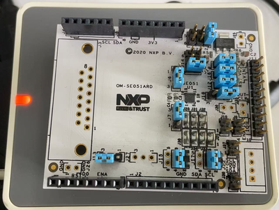

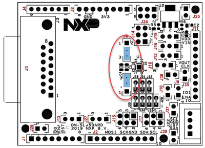

  • OM-SE05x-ARD has on board antenna which is disconnected from SE05x by default. To enable this antenna, please set J6 and J7 on board to position 2-3.
  • Connect the NFC reader with PC and place the OM-SE05x-ARD board on the reader.

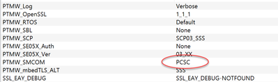

MW Configuration
Please following the guide in https://www.nxp.com/docs/en/application-note/AN12398.pdf to set up the MW , the only difference setting is the SMCOM:

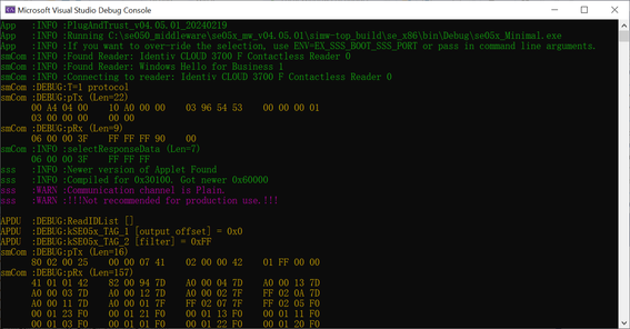

Demo Show
With above, you may play any of demo out of the MW via the NFC reader.
