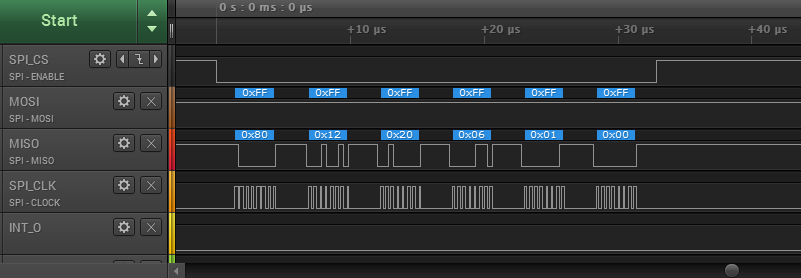

Hi Jacques,
I switched the data description to HEX this is why the first capture was not making sense.
I am going to have to split it because I can display all of it at once.
First Half of the Wake-Up command
Second Half of the Wake-Up command
Final Half of the Wake-Up command
The Wake-Up command is followed by the sanity check of it by reading it back.
First Half of the Read of the Wake commad
Second Half of the Read of the Wake command
The response is still the same as above.  It seems that the unit is ACKing properly with each byte sent, but according to the result displayed,
the MMA9555L is replying with FF for all fields.
Can you spot what could be happening?

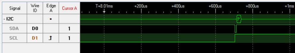

Hi Jacques,
Here is a better capture
Not sure what this is?
Response
Not sure if you can make any sense of this?
Neil

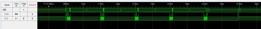

I just got this logic analyser and I am learning how to set it up and capture my communication.
Here is a capture of the wake-up portion.   HEX  98(address TX), 12(AP ID), 20(write command), 06(offset), 01(bytes to write), and 00(wake-dude!)
I will do the same tomorrow for the other commands, please let me know what you think so far?
Thank you,
Neil

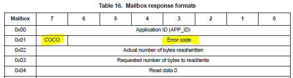

JackITB
Hi Neil,
Hard to say from the picture, besides the fact that SDA and SCL on the table are swapped compared to their plots (Red is SCL).
I recommend also that you perform a "read response" after each command (+ a few ms delay) to make sure it has completed without error. Second byte shall be 0x80, as per datasheet §4.3.3 page 23:
