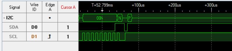

neilporven
Senior Contributor I
Sorry Jacques,
I just got this logic analyser and I am learning how to set it up and capture my communication.
Here is a capture of the wake-up portion.   HEX  98(address TX), 12(AP ID), 20(write command), 06(offset), 01(bytes to write), and 00(wake-dude!)
I will do the same tomorrow for the other commands, please let me know what you think so far?
Thank you,
Neil

JackITB
Hi Neil,
Hard to say from the picture, besides the fact that SDA and SCL on the table are swapped compared to their plots (Red is SCL).
I recommend also that you perform a "read response" after each command (+ a few ms delay) to make sure it has completed without error. Second byte shall be 0x80, as per datasheet §4.3.3 page 23:

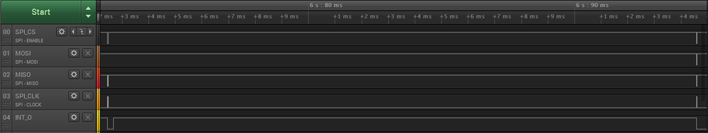

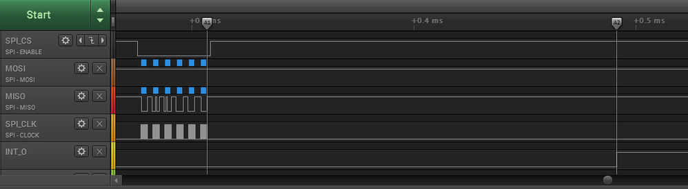

JackITB
Hello Neil,
After a quick test on KITMMA9555LEVM demokit, I've no issue to program the INT_O sensor pin as "Command completed" Interrupt line.
Here is the communication between host MCU and MMA9555L as well as INT_O signal.
WRITE TRANSACTION :: Starting MB = 00
Write : 12 20 06 01 00 // disable sleep mode (STOPNC) in Sleep-Wake Application
Write : 18 20 00 01 80 // enable INT_O (to flag command completed) in Mailbox Application
Once this command is completed (takes about 185µs), INT_O is asserted and will stay so till next transaction on MMA9555 slave interface
Write : 1A 30 00 01 // query SixDir Status register in 6-axis Application
This command immediately clears INT_O line. Then after command is completed and results made available in the mailboxes, INT_O is asserted (goes high) so the host MCU knows data is ready and can be read
MMA9555-INT_O.PNGREAD TRANSACTION :: Starting MB = 00, No. bytes to read = 5
Read : 1A 80 01 01 06 // board sits horizontal on the table => orientation = +Z
This clears the INT_O line again.
Please provide communication log so we can check the traffic between your MCU and sensor.
