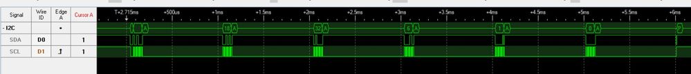

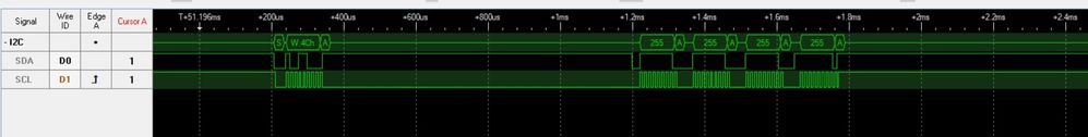

neilporven
Senior Contributor I
Sorry Jacques,
I just got this logic analyser and I am learning how to set it up and capture my communication.
Here is a capture of the wake-up portion.   HEX  98(address TX), 12(AP ID), 20(write command), 06(offset), 01(bytes to write), and 00(wake-dude!)
I will do the same tomorrow for the other commands, please let me know what you think so far?
Thank you,
Neil
893 Views
JackITB
Hi Neil,
Hard to say from the picture, besides the fact that SDA and SCL on the table are swapped compared to their plots (Red is SCL).
I recommend also that you perform a "read response" after each command (+ a few ms delay) to make sure it has completed without error. Second byte shall be 0x80, as per datasheet §4.3.3 page 23:
893 Views
