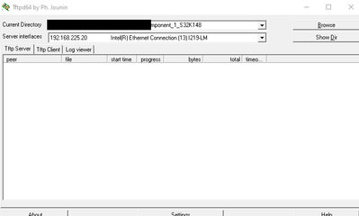

Hello ,
i want to update the software on my board via TFTP,this will be usefull if the board is enclosed in a plastic or metalic cover, the idea is
  • PC will run a TFTP server containing all SW files
  • S32k will run a TFTP client that will ask (by file name) the server for the flash file
  • S32k will receive the flash file and start the SW update (erase all flash memory and write).
Is there a code example for that ? I have found this example client on github, but I get always a fail in “failed to open file”.
im using the Tftpd64 as TFTP server.
Best regards.

Kazarian
i have integrated the code to the project, the S32K148 can start the TFTP client, but i get an issue in "tftp_open_file".
Firewall UPD port 69 is open for both ongoing and outgoing packet.
TFTP server is runing and pointing to the location where the file is.
attached the source code used.
Thank a lot for the help !
