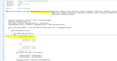

We are using s32k14x_ CSEC_ MCAL4_ 0_ RTM_ 1_ 0_ 4. Some questions and problems encountered in the process of sample application:
1,MASTER_ ECU_KEY  key is loaded successfully,and load CSEC_KEY_18 When CSEC is loaded_ KEY_ Feedback to CSEC CSEC_KEY_18 return ERC_ KEY_ INVALID;

1.2.3: I checked the sample project in  s32k14x_ CSEC_ MCAL4_ 0_ RTM_ 1_ 0_ 4, you're right that the example code is having trouble when load CSEC_KEY_18.
I compared the code with the newest code in RTD package of RTD SW32K1_RTD_4.4_1.0.1:
I removed a block code in function SampleAppUpdateKeyProtocolTest() in sample_app_mcal_csec_task.c then the sample project will works normally.
