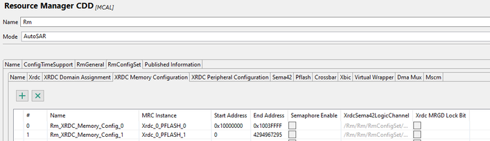

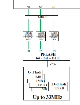

when looking at the MRC configuration table (chapter 19.1.2 table 68; ref manual rev 7), the program flash block PFLASH 0-3 are listed. However, I cannot find the DFLASH.
Is the DFLASH stated as "PFLASH_WR"?
If not, what is PFLASH_WR?
If yes: I could not find any reference between PFLASH_WR and DFLASH, as PFLASH_WR is used exactly 1 time in the whole ref manual.
Thank you
Andreas

Hi Andreas,
All the ports have access to DFlash.
Use the RM MCAL RTD driver to configure the MRC0.
PFLASH_WR is for programming, discussed here already:
https://community.nxp.com/t5/S32K/XRDC-Memory-regions/td-p/1844979
