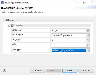

I tried to export my S32DS project to IAR EWARM by referring to the link below.
HOWTO: Export S32DS Project to IAR EW (S32K14x/S32K11x)
If I did not select SDKs, I was able to debug successfully.
S32K311Eva_woSDK_NoSDK.PNGS32K311Eva_woSDK_NoSDK.PNGS32K311Eva_woSDK_Debug.PNGS32K311Eva_woSDK_Debug.PNG

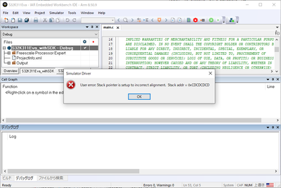

However, if I select a SDK, a stack pointer alignment error occurs when debugging starts.
S32K311Eva_withSDK_selSDK.PNGS32K311Eva_withSDK_selSDK.PNGS32K311Eva_withSDK_Debug.PNGS32K311Eva_withSDK_Debug.PNG
I set "alignment = 8" in the icf file but no improvement.
The project is not modified from the one generated by S32DS, do I need to make any changes?

jiri_kral
can you please share more details? Is there some error message? Normally is stack pointer stored on very first 4 bytes after boot header - not sure exact address for K311, for K344 it is 0x401000 and address of stack beginning is taken from linker script file.

jiri_kral
you are using S32K1xx linker script file with S32K3xx and the stack pointer address is taken from boot header instead of correct SP address. Please use correct linker script file.

jiri_kral
I'm not familiar with IAR, but in my opinion there is no issue with alignment - the stack pointer address seems invalid for some reason.
