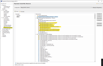

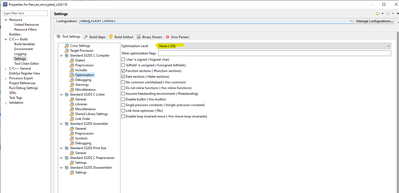

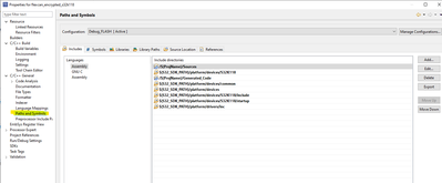

Getting Error of invalid project path:
Steps performed:
  1. Uninstall and reinstall Design Studio
  2. Used New workspace
  3. Created a project with example project
  4. Compiled the project.
Please refer the snapshots (pasted+ attached)of Design Studio settings;

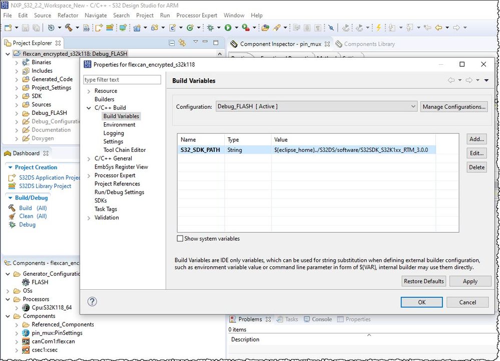

Please check the Build Variables:
When delete the S32_SDK_PATH, I will get the same issue.
The value of S32_SDK_PATH exists by default after importing the project.
${eclipse_home}../S32DS/software/S32SDK_S32K1xx_RTM_3.0.0

I tried this method, it does not work too.
