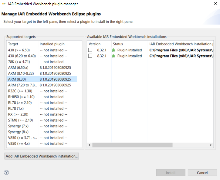

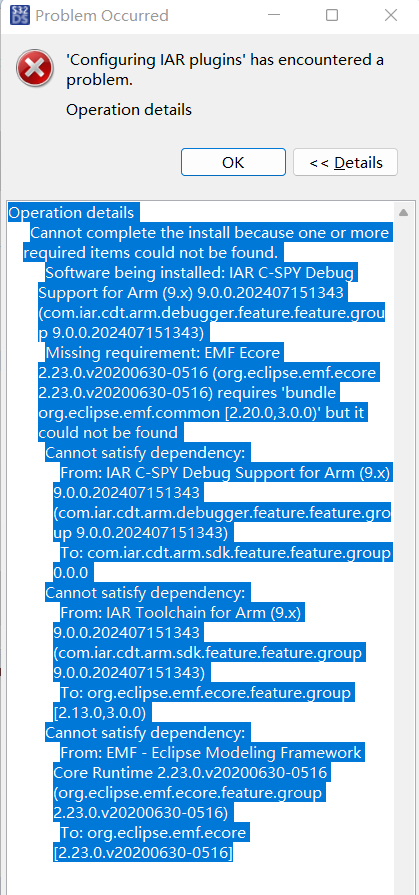

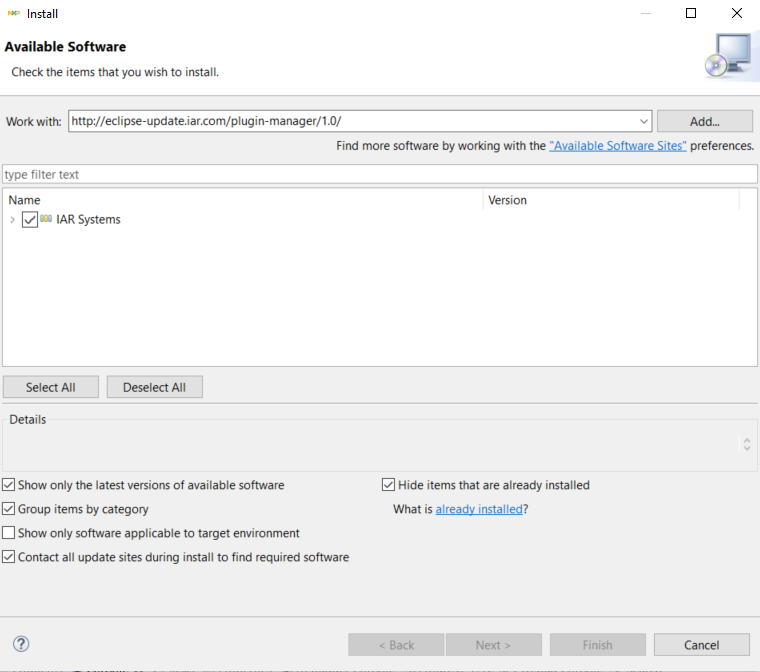

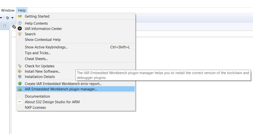

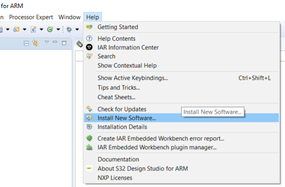

1. Install IAR Plugin using IAR Embedded Workbench plugin manager on S32DS
  • Help - Install New Software
  • Help - IAR Embedded Workbench Plugin Manager
  • Install IAR Plugin which is matched with your IAR version.

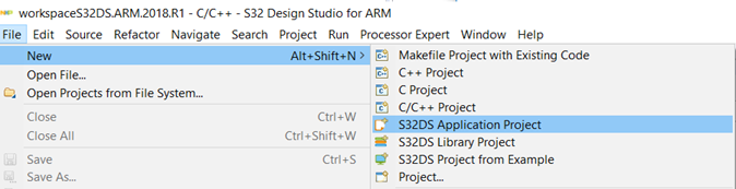

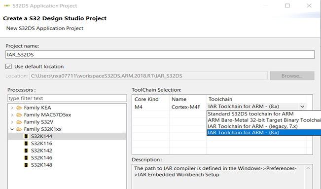

2. Create S32DS Project
  • File - New - S32DS Application Project
  • The tool chain should be chosen as IAR Toolchain. Be noted that the IAR 7.x toolchain is different from the IAR 8.x.
  • The project is created as follows.

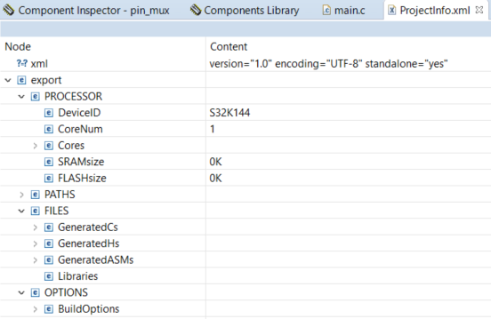

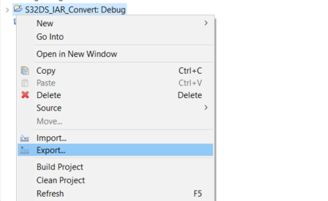

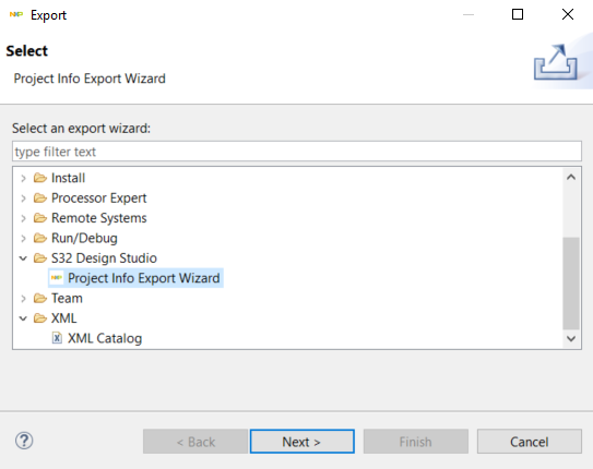

3. Export S32DS Application Project
  • File - Export
  • Choose S32 Design Studio - Project Info Export Wizard
  • Now "ProjectInfo.xml" was created. "ProjectInfo.xml" should be used for creating a project in the IAR EW.

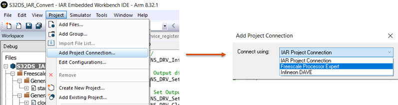

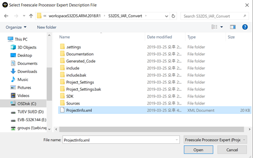

5. Connect the Project
  • Use the menu - Project - Add Project Connection, and choose "Freescale Processor Expert".
  • Select the "ProjectInfo.xml" file which was created at step #3.
Now, the project which had been created in IAR was connected to the S32DS project.

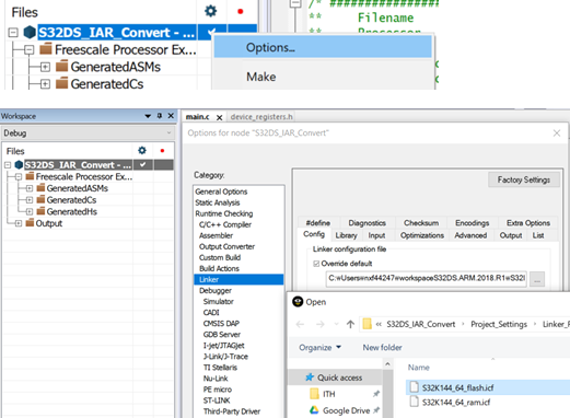

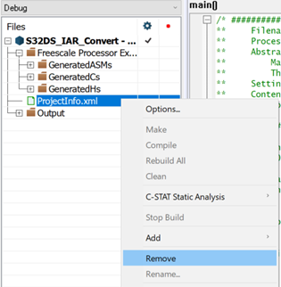

1. Modify the Linker configuration and remove ProjectInfo.xml
  • Remove "ProjectInfo.xml"
  • Linker configuration from the project Options

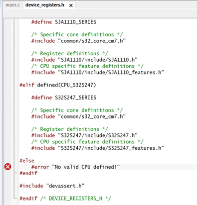

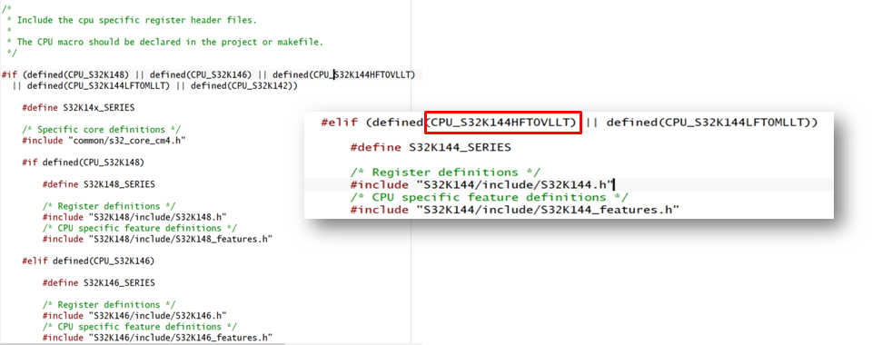

Even though the user modified the linker configuration, a definition in IAR EW  for "device_registers.h" from SDK will cause build error when trying building the project.
This error will be eliminated by inserting Chip specific definition into IAR project. If you take a look into the "device_register.h", you can find the definition as follows.

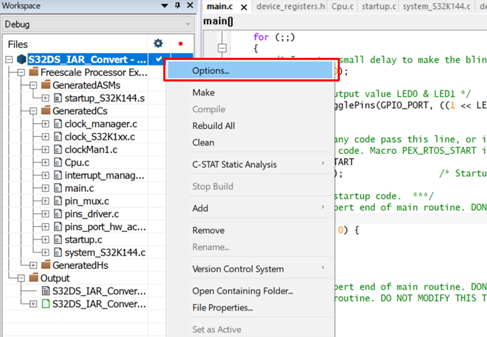

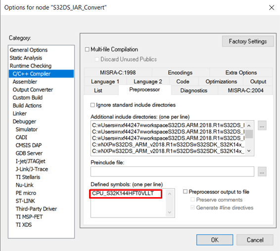

2. Define symbols
  • Right mouse click on the Project name - Options
  • Write the symbols referred from "device_register.h". The symbols may vary (e.g., CPU_S32K146, CPU_S32K142, ...).

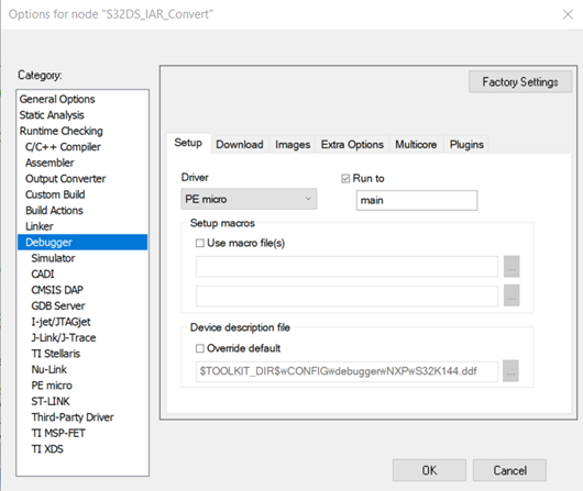

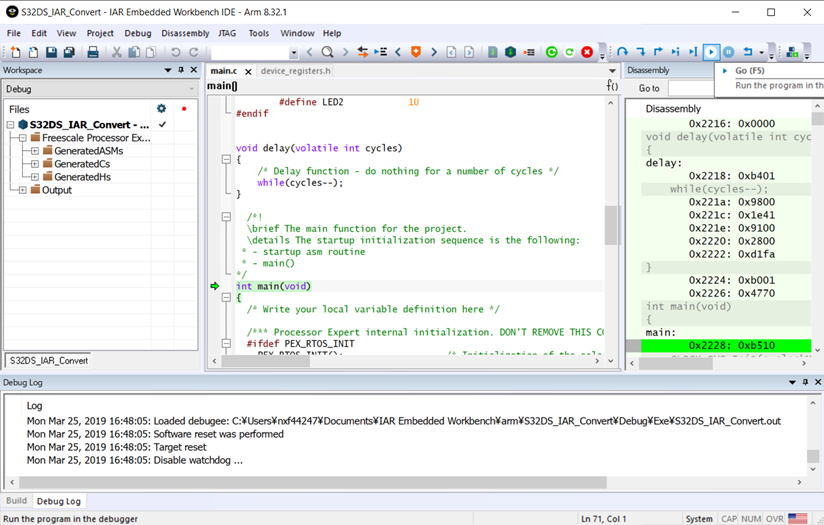

3. Build and Debugger configuration
  • Options - Debugger

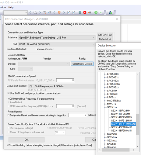

  • I used PE micro's OpenSDA on S32K144EVB for this document. After choosing debugger and clicking Download and Debug (Ctrl+D), you can see the P&E Configuration Manager as follows. Just choose appropriate configuration, and select the correct part number of S32K by clicking Select New Device.
Finally, you can download and debug the converted IAR EW project with S32DS SDK.

I encountered some issues during the step 'Install IAR Plugin which is matched with your IAR version.' Could you help me figure out how to resolve this?
Error message as follows
Operation details
Cannot complete the install because one or more required items could not be found.
Software being installed: IAR C-SPY Debug Support for Arm (9.x) 9.0.0.202407151343 (com.iar.cdt.arm.debugger.feature.feature.group 9.0.0.202407151343)
Missing requirement: EMF Ecore 2.23.0.v20200630-0516 (org.eclipse.emf.ecore 2.23.0.v20200630-0516) requires 'bundle org.eclipse.emf.common [2.20.0,3.0.0)' but it could not be found
Cannot satisfy dependency:
From: IAR C-SPY Debug Support for Arm (9.x) 9.0.0.202407151343 (com.iar.cdt.arm.debugger.feature.feature.group 9.0.0.202407151343)
To: com.iar.cdt.arm.sdk.feature.feature.group 0.0.0
From: IAR Toolchain for Arm (9.x) 9.0.0.202407151343 (com.iar.cdt.arm.sdk.feature.feature.group 9.0.0.202407151343)
To: org.eclipse.emf.ecore.feature.group [2.13.0,3.0.0)
From: EMF - Eclipse Modeling Framework Core Runtime 2.23.0.v20200630-0516 (org.eclipse.emf.ecore.feature.group 2.23.0.v20200630-0516)
To: org.eclipse.emf.ecore [2.23.0.v20200630-0516]
