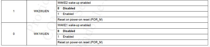

Hello NXP Team,
My question is about WAKE_UP-1 & WAKE_UP-2 Pins in FS26 IC.
Do we require both the Wake Pins to be toggled to completely on the IC or using only one to wakeup is Enough ?

Hello Abhiram,
Using one WAKEx pin is enough.
Please note that you need to enable it using the WK1WUEN or WK2WUEN bit in the M_WIO_CFG register before entering the Standby/LPOFF mode. Else the FS26 will be stuck until a power-on reset event.
