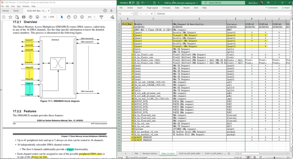

DMA sources called slots can be found in DMA_CH_MUX of S32K1xx_DMA_Interrupt_mapping.xlsx.
Do you want to use BAUD[TDMAE] configures the transmit data register empty flag, STAT[TDRE], to generate a DMA request? (Peripheral request)Slot_Num 3 is the Transmit DMA Request of LPUART0.
TRGMUX_IN0 belong to Trigger not Peripheral request.  Seems that you want to achieve 17.4.1 DMA channels with periodic triggering capability
