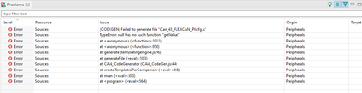

We're trying to use CANFD and Enhanched FIFO  on an s32k3 target with MCAL S32K3_RTD_3_0_0_D2303_ASR_REL_4_7_REV_0000_20230331 using S32DSstudio
Version: 3.5
Build id: 230929 (Update 6)
And using Can43_flexcan in Autosar Mode.
But we are getting the following error in generation phase

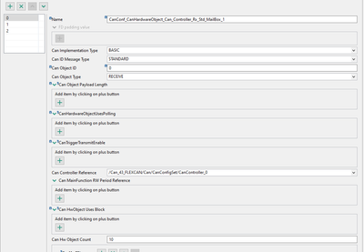

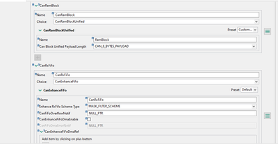

Below some configurations

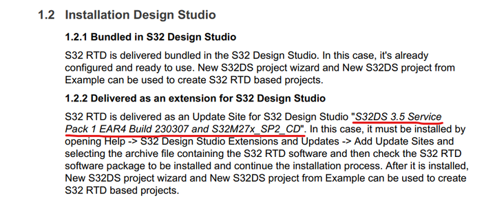

I think it's lack of resources. Please install the Service Pack 1 EAR4 as in Release Notes mentioned.
Please try to install another S32DS then the Service pack 1. I remember that user can't downgrade the DS-update version.
