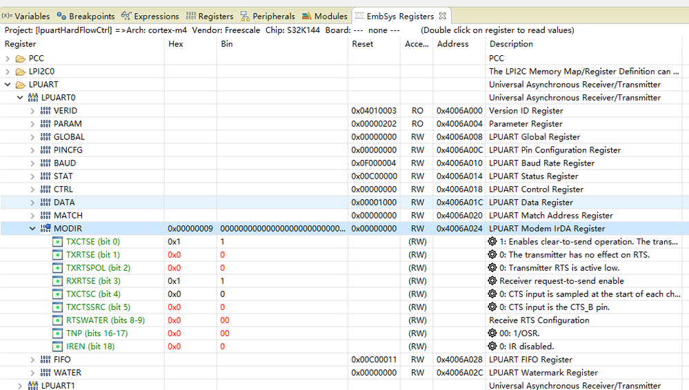

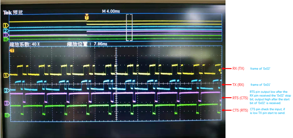

I write a doc and a demo about LPUART hardware flow control, runs on s32k144 evb board with RTM 3.0.0, the flow control function work normally. If you have any question please contact me.

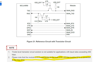

In your code, CTS<-> RTS and RTS<-> CTS but if CTS connected to CTS and RTS to RTS, what should be changed in the code?
