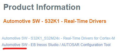

NamLee
Hi spara7c5,
Please enter this one in Flexera, when you try to download RTD K1 package.
Design : Product Information : Automotive SW - S32K1 - Real-Time Drivers (flexnetoperations.com)
Version 29.0.0 is available here from side.
Design : Product Information : Automotive SW - EB tresos Studio / AUTOSAR Configuration Tool (flexne...
Please help me to try this.

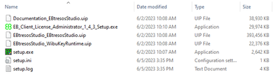

spara7c5
Hello @NamLee ,
I had an old uid file in my download folder, this is why the exe file didn`t point to the correct tresos version. I replaced it and the download works properly. Now the problem is that Tresos provided from NXP does no contain any BSW module (EB autocore,...) so I am only able to run simple MCAL applications.

NamLee
From my setup, if these files are existed so you can run the setup and also add license.
But it's ok if you've already done workaround and the EB works.
