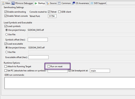

danielmartynek
HI @Masaki_Mori,
Can you disable Run on reset in the debug configuration and step through the code from the reset vector after the image has been loaded? Is there is Fault exception detected?
