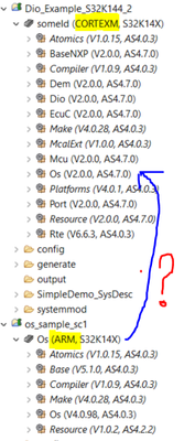

spara7c5
Hello @NamLee ,
I hope i can clarify with this screenshot:
The Os V2_0_0 AS4_7_0 is just the "dummy OS" contained in RTD.
The Os V4_0_98 is instead the real OS from NXP but it has two issue: it is for AS 4.0.3 instead 4.0.7 and most important it is based on ARM architecture instead of ARM-CORTEXM so I cannot find it in the module panel for a CORTEXM project (in this case Dio_Example_S32K144, which is a sample project in the RTD forlder)

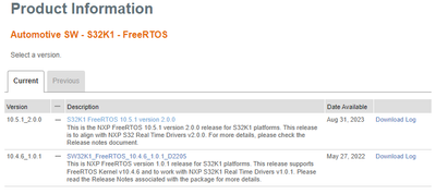

Hi spara7c5,
I've asked my collegues and got informed that real OS is a huge part and NXP supports FreeRTOS which for S32K1 RTD 2.0.0
For Autosar OS, unfortunately i also be able to find only one version like you. But i'm still trying to contact with managers of ASROS for clarification.
Also from my collegue he said that most of the APIs in the old version are kept and matching (following Autosar), so it still supposes to work with the old one.
Please help me to try the FreeRTOS above and wait me a little bit more for information of AutosarOS.

spara7c5
Hello @NamLee ,
I downloaded and installed SW32K1_S32M24x_FreeRTOS_10_5_1_UOS_2_0_0_DS_updatesite_D2308.
The problem is that there is only S32DS package. There is not the corresponding tresos plugin. So I cannot run the validation/generation of my project on tresos. Please help, thanks
