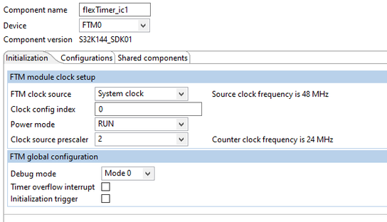

Hello Community
We want to detect the Crash signal input and configure it according to the example, but there is no return value of IC_GETMEASUREMENT (), please help us to check whether we made a mistake in the configuration.
Chip version:S32K148 -> 144
PIN: PTD18
Hardware environment: SRS analog input
Config: FTM5_CH7
for example: ic_pal_s32k148
MCU detects CRASH signal input,
uint16_t inputCaptureMeas = 0U;
uint16_t inputMeas = 0U;
uint32_t frequency;
uint8_t channel = ic_pal1_ChnConfig->hwChannelId;
IC_Init(&ic_pal1_instance, &ic_pal1_InitConfig);
while(1)
    frequency = FTM_DRV_GetFrequency(ic_pal1_instance.instIdx);
    inputCaptureMeas = IC_GetMeasurement(&ic_pal1_instance, channel);
    inputMeas = frequency / (inputCaptureMeas);
    JPCC_DEBUG(JPCC_LOG_LEVEL_WARNING, "[ SensorApp] 6 PWM uFrequencyHZ=[%lu],         frequency=[%lu], inputCaptureMeas=[%u], inputMeas=[%lu]\r\n",
    flexTimer_pwm1_PwmConfig.uFrequencyHZ, frequency, inputCaptureMeas, inputMeas);
    OS_sleep(300);
38,643 Views
danielmartynek
Looking at the screenshots you posted, I see the FTM frequency is set to 256Hz.
The resolution is therefore 1/256 = 3.9ms
3.9ms * 28 = 109.2ms which is 91% of 120ms.
If you need to have a higher resolution, you need to set a higher FTM frequency.

danielmartynek
The IC_GetMeasurement() function returns the duty-cycle value in FTM3 ticks (24MHz).
If you know the period of the input signal, you can easily calculate the duty-cycle in %.
38,724 Views
linglei_meng
Our input signal (Type)
T = 120ms.
Hz = 0.0083333333333KHz
How do we use the data we have to calculate the duty cycle?Could you give me an example? Thank you
38,707 Views
danielmartynek
The IC_GetMeasurement() function returns number of FTM ticks measured while the input signal is ON.
One FTM tick is one period of the FTM function clock.
Instead of the PAL driver, you can use the FTM_IC driver.
Example: ftm_signal_measurement_s32k148
With this configuration:
The driver can measure input signal:
If you need to measure signal of frequency 8.33Hz, you need to select a slower FTM clock.
For example,
In this case, 1 FTM clock cycle = 1 FTM tick = 1/62500 = 16us is resolution of the measurement.
You could use faster FTM clock frequency but you would need to count the FTM overflows and add it to the time captured between the two edges.

danielmartynek
