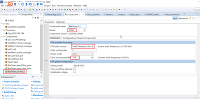

Looking at the screenshots you posted, I see the FTM frequency is set to 256Hz.
The resolution is therefore 1/256 = 3.9ms
3.9ms * 28 = 109.2ms which is 91% of 120ms.
If you need to have a higher resolution, you need to set a higher FTM frequency.

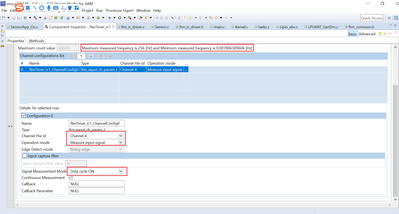

linglei_meng
Our input signal (Type)
T = 120ms.
Hz = 0.0083333333333KHz
Duty = 90%
FTM_DRV_GetInputCaptureMeasurement(INST_FLEXTIMER_IC1, 4U)  = 28;
1 FTM clock cycle = 1 FTM tick = 1/62500 = 16us is resolution of the measurement.
Duty cycle calculation formula:  (28 * 16us) / 120ms = 90%
Is that the calculation?
Could you specify the duty cycle calculation formula with the above parameters.

danielmartynek
