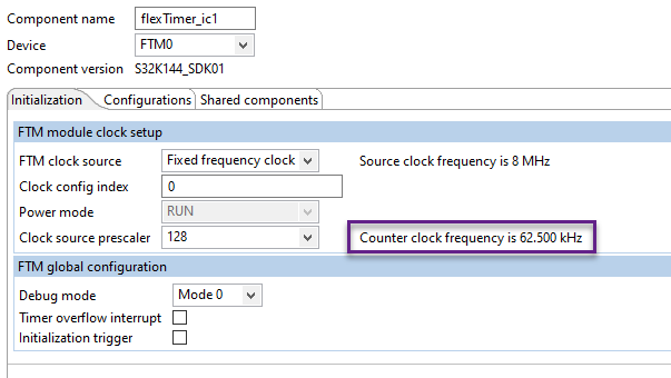

danielmartynek
The IC_GetMeasurement() function returns number of FTM ticks measured while the input signal is ON.
One FTM tick is one period of the FTM function clock.
Instead of the PAL driver, you can use the FTM_IC driver.
Example: ftm_signal_measurement_s32k148
With this configuration:
The driver can measure input signal:
If you need to measure signal of frequency 8.33Hz, you need to select a slower FTM clock.
For example,
In this case, 1 FTM clock cycle = 1 FTM tick = 1/62500 = 16us is resolution of the measurement.
You could use faster FTM clock frequency but you would need to count the FTM overflows and add it to the time captured between the two edges.

44,777件の閲覧回数
danielmartynek
Looking at the screenshots you posted, I see the FTM frequency is set to 256Hz.
The resolution is therefore 1/256 = 3.9ms
3.9ms * 28 = 109.2ms which is 91% of 120ms.
If you need to have a higher resolution, you need to set a higher FTM frequency.
