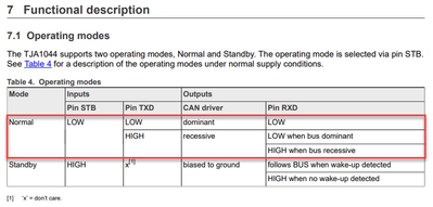

Hi @DanielYJHsieh,

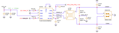

S32K312EVB uses a different transceiver than TJA1044. In your case, CAN_STB must be LOW for normal mode. From TJA1044's data sheet:
I can receiver 0x55 and 0xFACE ID CAN BUS.
How to config for more IDs

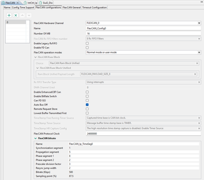

What should the Prop Seg/Seg 1/Seg 2/Pre Divider/Resync jump width of FlexCAN_Config0 be?
What does the PCAN VIIEW config should be?

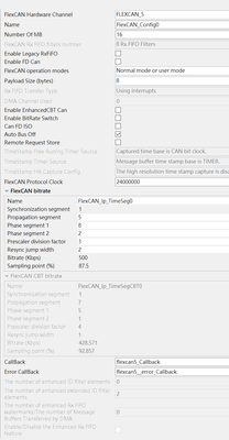

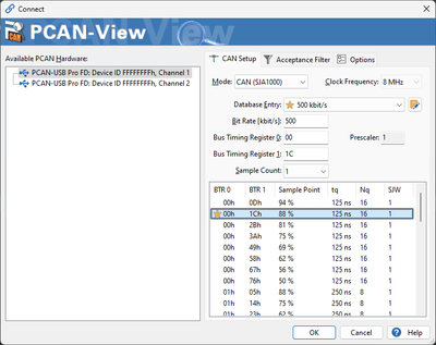

Julián_AragónM
Hi @DanielYJHsieh
Yes, if you are using FlexCAN5, simply change the configuration for instance 5.
You can use this spreadsheet calculator for CAN bit timing segments: MPC5xxx/S32Kxx/LPCxxxx: CAN / CAN FD bit timing calculation - NXP Community.

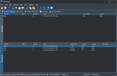

For testing purposes, match the same configuration in PCAN View and in MCU, for example:
S32K3 with 500Kbps & SP 87.5%:
PEAK View w/same config:
Bus status should be OK:

Julián_AragónM
Hi @DanielYJHsieh,

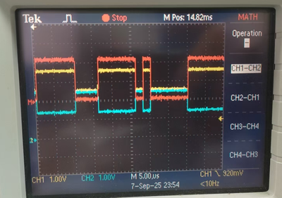

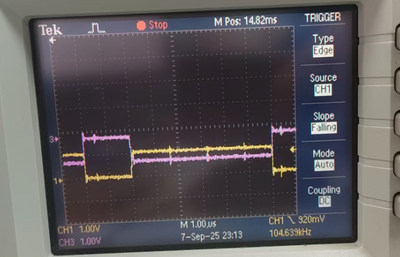

DanielYJHsieh
Dear @Julián_AragónM
I had double check the scope.
The rate is 500K as picture.
Any thing i need to check more?
PC Tool PCAN-view's waveform
Device side's waveform
The H-L math waveform

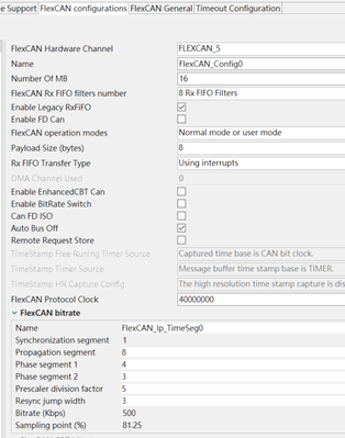

DanielYJHsieh
Could you please help to check following config is correct or not?
Me device's CAN become NG, however i did not change the config
The scope have waveform ,but the PCAN-view can not receiver message.
I suspect the device did not send the correct

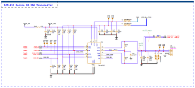

Hi @DanielYJHsieh,
Your basic configuration seems ok. Are you using an S32K312-EVB? Or is this a custom design? Please confirm if the pinout and CAN bus design is correct. You can base the design from the EVB (using a TJA1153 transceiver):
Also, I assume you are also configuring and initializing the clocks and pins correctly. You can use these community posts as reference:
