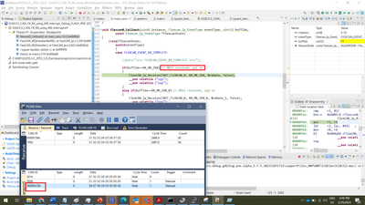

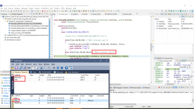

 The purpose of this demo application is to present a usage of the
 FlexCAN IP Driver for the S32K3xx MCU.
 The example uses FLEXCAN-0 for transmit & receive using following Message buffer :--
#define RX_MB_IDX_0 10U
#define RX_MB_IDX 11U
#define TX_MB_IDX 12U
BAUDRATE : 500 KBPS
* Test HW: S32K3X2EVB-Q172
* MCU: S32K312
* Compiler: S32DS3.5
* SDK release: RTD 3.0.0
* Debugger: PE micro
* Target: internal_FLASH
