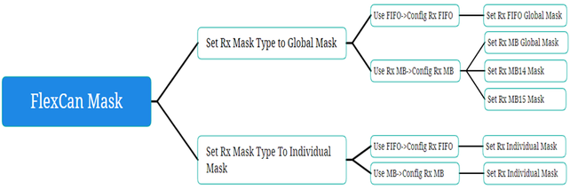

1.FlexCAN Mask Setting Overview
         S32K1XX FlexCAN support  Frame mask function ,as you can see the FlexCAN mask can be set to Global Mask or Individual Mask,and user can choose to use FIFO or MB to receive message,but only MB can be used for sending messages.and one more thing you should be care is that the FIFO can not be used for CAN FD,this is because the FIFO data filed only support 8 bit datafiled.
        If you use MB14 or MB15, have to set the mask of these tow MBs separately,and you can take a look at the two functions in the below.
->FLEXCAN_DRV_SetRxMb14Mask();
->FLEXCAN_DRV_SetRxMb15Mask();

4.FlexCAN_RX_MB_Mask_Setting
4.1.Set the Mask Type to Global Mask Type.
     In this case, we can only receive the messages which ID from 0x300~0x37F and 0x400~0x47F.
     If you try to sent the messages with other ID's, the S32K142EVB will not have any reponse!
4.2.Set the Mask Type to Individual Mask Type.
     In this routine,we can only receive frames with IDs in the range of 0x400~0x47F.
5.FlexCAN_RX_FIFO_Mask_Setting
5.1.Set the Mask Type to Global Mask Type.
0x10~0x17, 0x20~0x27,0x30~0x37,0x40~0x47,
0x50~0x57,0x60~0x67,0x70~0x77,0x80~0x87.
5.2.Set the Mask Type to Individual Mask Type.
     In this routine, we can only receive frames with IDs in the range of
0x10~0x17,0x20~0x27,0x30~0x37,0x40~0x47,
