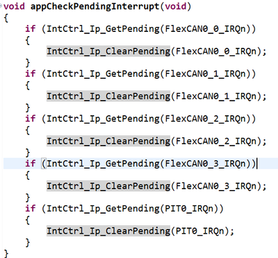

Hi Nxp Community,
        I am working on Lpspi+eDMA/PIT/CAN/EEPROM modules on S32K3. It is necessary to check if interrupts are serviced. I don't know Which registers indicate pending interrupts. Is there any solution?
Looking forward to your reply.
BR,
Sylvia

Hello @Sylvia_jiang,
That is really application-dependent.
The code you posted clears pending interrupts.
BR, Daniel

danielmartynek
Hi Sylvia,
If there is pending interrupt, the corresponding NVIC_ISPRn and NVIC_ICPRn bit is set.
For more information about NVIC, please refer to ARM®v7-M Architecture Reference Manual.
The S32K3xx NVIC interrupt mapping is specified in the S32K3xx_interrupt_map.xlsx file that is attached to the RM.

            Thank for your sending me map file and I have downloaded it. I try to use IntCtrl_Ip_GetPending api that is defined in IntCtrl_lp.c to check pending interrupts and use IntCtrl_Ip_ClearPending to clear pending interrupts as below. Is it correct action? Is there any matters I need to pay attention to?

danielmartynek
BR, Daniel
