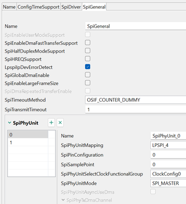

It seems that your code fails in the Lpspi_Ip_UpdateTransferMode() function. How do you call this function? Also, could you share the SPI configurations?

The below mentioned are the SPI configurations,
SpiDriver
SpiGeneral
5,394 次查看

It seems to be a hardware problem. Since the Hard fault occurs during clock initialization, a possible root cause could be the connections of the EXTAL and XTAL pins, for this you can use as a reference the Hardware Design Guidelines for S32K3xx Microcontrollers.
