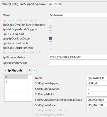

It seems that your code fails in the Lpspi_Ip_UpdateTransferMode() function. How do you call this function? Also, could you share the SPI configurations?

The below mentioned are the SPI configurations,
SpiDriver
SpiGeneral
5,448件の閲覧回数
