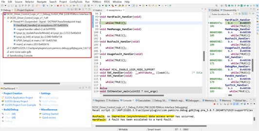

Hi @abdul_rahman
Could you share a picture of the Debug tab displayed on the left side of the S32DS during debugging? This tab shows where the code failed.
5,656 Views
abdul_rahman
Dear @VaneB,
Here is the screenshot of the right side of debug window you requested.
What could be the problem?
5,647 Views
VaneB
Hi @abdul_rahman
It seems that your code fails in the Lpspi_Ip_UpdateTransferMode() function. How do you call this function? Also, could you share the SPI configurations?

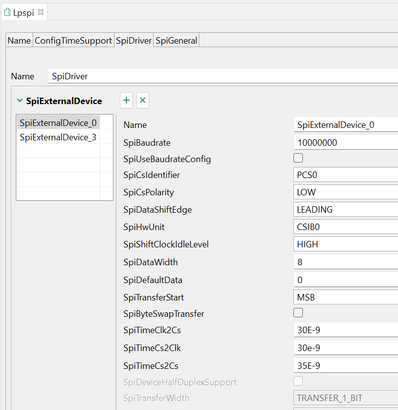

The below mentioned are the SPI configurations,
SpiDriver
SpiGeneral
5,543 Views
