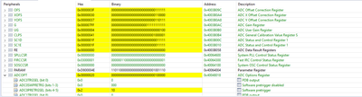

I gave longer sample time =250 and slower ADC clock =24Mhz and I am still getting the output RA as 0 or 4095.
I have attached my register values below,

3,475件の閲覧回数
sarwath
I have attached my ADC0 register values,
RA values is 0xFFF so I am getting 4095 as my ADC0 result
