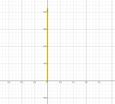

Hello Community,
S32k144 part number : FS32K144HAT0MLLT
I am facing issue with the ADC conversion.
My bus clock (48Mhz) and ADC clock (24MHz) with 12 bit resolution and 12 sample time.
Vin= 0 to 3.3v.
I am got the ADC output for my Vin (0 to 3.3). I only get results 0 or 4095. I'm not getting a linear output. Instead, I'm getting low(0) and high(4095) values . How to solve this problem.

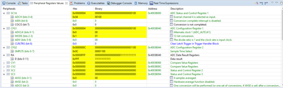

I gave longer sample time =250 and slower ADC clock =24Mhz and I am still getting the output RA as 0 or 4095.
I have attached my register values below,
B.R,
Sarwath

I have attached my ADC0 register values,
RA values is 0xFFF so I am getting 4095 as my ADC0 result
