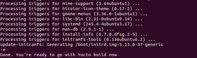

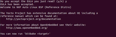

My steps are as follows:
1. tools version
2. Getting the Yocto image,everything looks normal
3. Build Linux BSP, Report some error
a. sudo apt update
b. ./sources/meta-alb/scripts/host-prepare.sh
c. source nxp-setup-alb.sh -m s32g399aevb3
d.bitbake fsl-image-auto, error
The previous preparations seem to be fine, but the build fails. How can I troubleshoot the problem?

Hello, @learnx
Thanks for the question
From the BSP user manual, all operating steps are validated on ubuntu20.04 LTS, may I know if you are using the same version Ubuntu as the building host? I also tried the same building locally but do not find any issues.
Seems it is a connection problem, would you please help to check if you have connecting issue to the github? then try another build.
Best Regards
Chenyin
1,584 Views
learnx
My local git configuration problem has been solved, thank you
