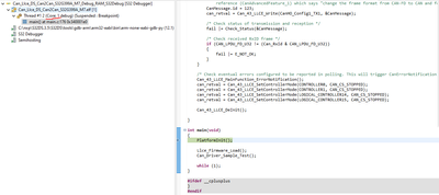

Is there a document that describes how to change the core to be debugged from Core0,
or is there a sample program that is running on a debugger other than Core0?

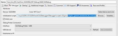

From our side we are able to debug the project with M7_1:
Aside from changing the core, the "Initialization script" needs to be changed to "s32g3xx_generic_bareboard_all_cores.py", as shown below:
With this said, this is only to start debugging. Since the project was designed for M7_0 on mind, undefined behavior might happen.
