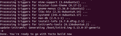

My steps are as follows:
1. tools version
2. Getting the Yocto image,everything looks normal
3. Build Linux BSP, Report some error
a. sudo apt update
b. ./sources/meta-alb/scripts/host-prepare.sh
c. source nxp-setup-alb.sh -m s32g399aevb3
d.bitbake fsl-image-auto, error
The previous preparations seem to be fine, but the build fails. How can I troubleshoot the problem?

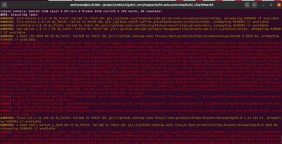

error log

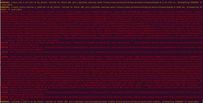

Hello, @learnx
Thanks for the question
From the BSP user manual, all operating steps are validated on ubuntu20.04 LTS, may I know if you are using the same version Ubuntu as the building host? I also tried the same building locally but do not find any issues.
Seems it is a connection problem, would you please help to check if you have connecting issue to the github? then try another build.

My local git configuration problem has been solved, thank you
