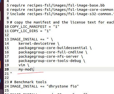

Ada_Lovelace
I add my-mod into the fsl-image-auto.bb ,it works.
And it has  IMAGE_INSTALL += "openssl-misc  in it.

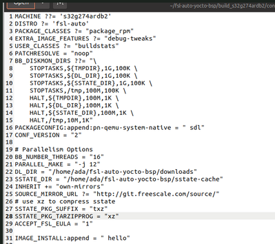

I reference the link,and change the file:  .bb and local.conf, but it has problems.
I add IMAGE_INSTALL_append = "hello" to local.conf, the bitbake image, it reports errors.
I upload the .c .bb makefie and local.conf, please help me how to make it work.

Ada_Lovelace
Hi,Tushar
I copy your files and put in to ./source but it still has errors.
I compare the files , layer.conf  is different, others are same. Then I set up the new layer referencing your steps, it reports the same error.
I put the location in the picture, I do not know what it is wrong,please help me check it.
Ada_Lovelace_3-1682495199870.pngAda_Lovelace_4-1682495216153.pngAda_Lovelace_5-1682495230991.png

nxf92355
Hi Ada
One things may be with you.i am not sure .  Did you made any change in any file or any .bb file ?
The erro you are getting
Missing or unbuildable dependency chain was: ['fsl-image-auto', 'openssl-miscmy-mod']
means your image fsl-image-auto is depending/appending on openssl-miscmy-mod named package or .bb file. do you have any recipe file named as openssl-miscmy-mod ?  i think there are no any like named file. did you made any mistake in file at /bsp-auto/sources/meta-alb/recipes-fsl/images/fsl-image-auto.bb ?  i open that file and i am seen there package as named  openssl-misc
# Supporting complex evaluation scenarios
IMAGE_INSTALL += "openssl-misc"
did you change this ?
if you not finding then please search for openssl-miscmy-mod  as
~/bsp-auto/sources/meta-alb$ grep -nr openssl-miscmy-mod
you will find . open this and correct
Hope this will helps you
Thanks & Regards
Tushar

Ada_Lovelace
5,271 次查看
nxf92355
Hi Ada
that's good problem has been solved. did you find root cause of issue for the error you was getting "Missing or unbuildable dependency chain was: ['fsl-image-auto', 'openssl-miscmy-mod']"  tell us the steps to regenerate that issue
i had tried to regenerate the issue as you was getting . but i was not getting issue like you have. commonly such type of issue is generated as i explain in my previous post . so that to regenerate issue i have replaced manually "openssl-miscmy-mod" instead of "openssl-misc" in fsl-image-auto.bb  as below
