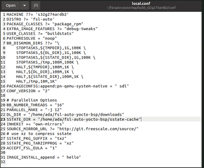

I build the board s32g274ardb2, it  can make the image. Now I want to add new layer to project, so I  setup the new layaer meta-mylayer, I create the .bb .c and makefile.
Then I add the meta-mylayer path to  bblayers.conf.
Then  I  build fsl-image-auto, I test  it ,  the code about the layer does not work.
I search the question,  I need to add the layer to the image. I do not find hello.ko ,so I think it needs some steps, what should I do to add the layer to image?
I upload the meta-mylayer and build configuration.

I reference the link,and change the file:  .bb and local.conf, but it has problems.
I add IMAGE_INSTALL_append = "hello" to local.conf, the bitbake image, it reports errors.
I upload the .c .bb makefie and local.conf, please help me how to make it work.

I think in newer versions for yocto,  syntax may be changed. You can try
IMAGE_INSTALL:append instead of IMAGE_INSTALL_append

I IMAGE_INSTALL:append instead of IMAGE_INSTALL_append , it also has errors.

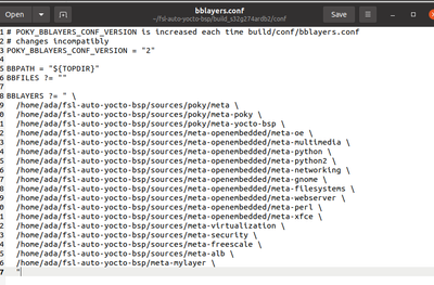

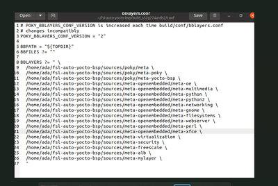

Hi,Tushar
I copy your files and put in to ./source but it still has errors.
I compare the files , layer.conf  is different, others are same. Then I set up the new layer referencing your steps, it reports the same error.
I put the location in the picture, I do not know what it is wrong,please help me check it.

One things may be with you.i am not sure .  Did you made any change in any file or any .bb file ?
The erro you are getting
Missing or unbuildable dependency chain was: ['fsl-image-auto', 'openssl-miscmy-mod']
means your image fsl-image-auto is depending/appending on openssl-miscmy-mod named package or .bb file. do you have any recipe file named as openssl-miscmy-mod ?  i think there are no any like named file. did you made any mistake in file at /bsp-auto/sources/meta-alb/recipes-fsl/images/fsl-image-auto.bb ?  i open that file and i am seen there package as named  openssl-misc
# Supporting complex evaluation scenarios
IMAGE_INSTALL += "openssl-misc"
did you change this ?
if you not finding then please search for openssl-miscmy-mod  as
~/bsp-auto/sources/meta-alb$ grep -nr openssl-miscmy-mod
you will find . open this and correct
Hope this will helps you
