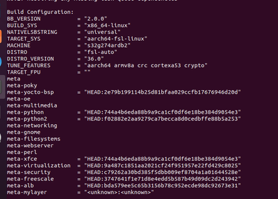

I upload the meta-mylayer and build configuration.

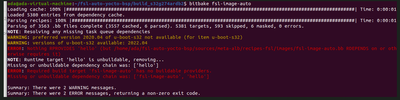

I reference the link,and change the file:  .bb and local.conf, but it has problems.
I add IMAGE_INSTALL_append = "hello" to local.conf, the bitbake image, it reports errors.
I upload the .c .bb makefie and local.conf, please help me how to make it work.

I think in newer versions for yocto,  syntax may be changed. You can try
IMAGE_INSTALL:append instead of IMAGE_INSTALL_append
for more information for syntax please see your yocto version. i mean Honister , Hardknott , Gatesgarth , Dunfell , Zeus or else

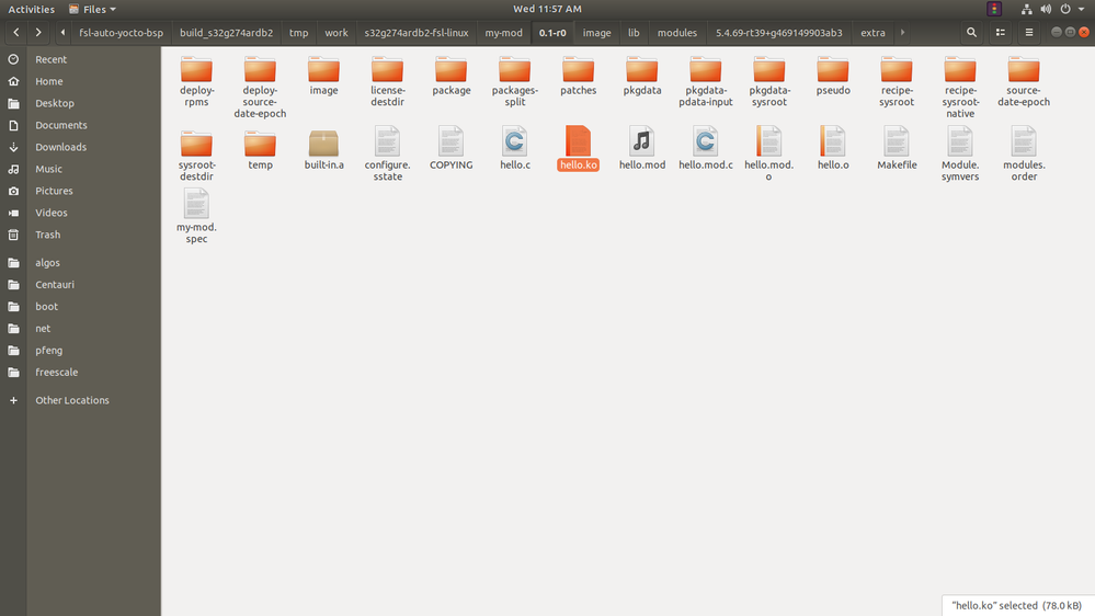

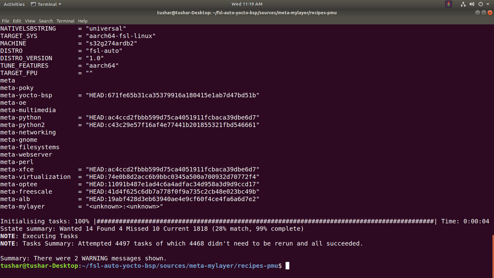

I have followed same link which i have shared with you. and i getting success to yocto build.and hello.ko is also built. below is my steps which i have followed
bitbake-layers create-layer ../sources/meta-mylayer
bitbake-layers add-layer ../sources/meta-mylayer
cd ../sources/meta-mylayer/
rm -rf recipes-example/
mkdir recipes-pmu
cd recipes-pmu/
cp -fvR ../../../sources/poky/meta-skeleton/recipes-kernel/hello-mod .
cd hello-mod/
mv hello-mod/ my-mod/
cd my-mod/
mv hello-mod_0.1.bb my-mod_0.1.bb
vi ../../../build_s32g274ardb2/conf/local.conf    ( Added IMAGE_INSTALL_append = " my-mod")
bitbake fsl-image-auto
yocto build sucess without any error
hello.ko
I think you may be missed some steps  from links. you can rebuild again with proper caution.
I have attached mylayer zip file . you can also compare it with yours.

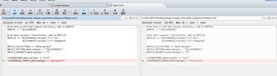

Ada_Lovelace
Hi,Tushar

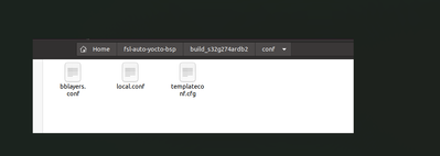

I copy your files and put in to ./source but it still has errors.
I compare the files , layer.conf  is different, others are same. Then I set up the new layer referencing your steps, it reports the same error.
I put the location in the picture, I do not know what it is wrong,please help me check it.
Ada_Lovelace_3-1682495199870.pngAda_Lovelace_4-1682495216153.pngAda_Lovelace_5-1682495230991.png

nxf92355
Hi Ada

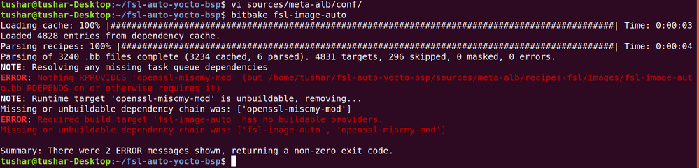

One things may be with you.i am not sure .  Did you made any change in any file or any .bb file ?

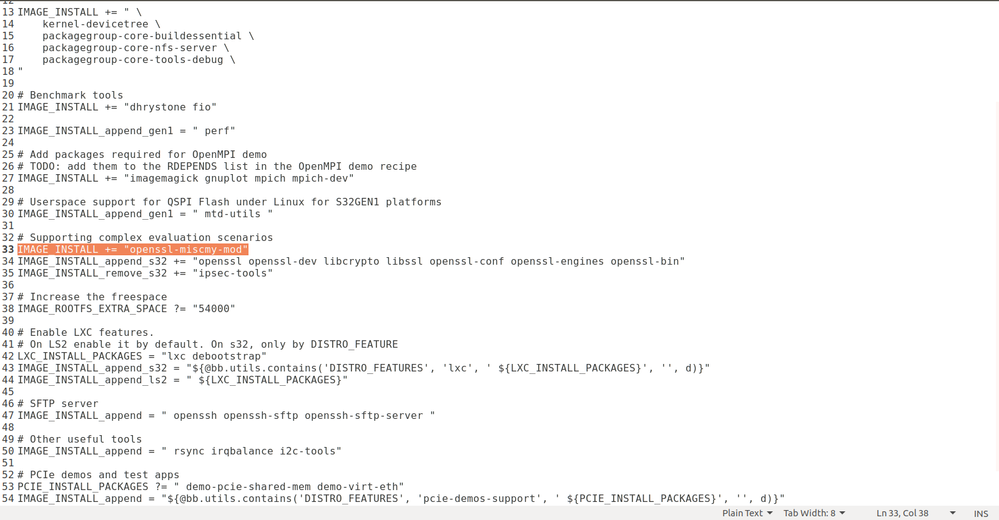

The erro you are getting
Missing or unbuildable dependency chain was: ['fsl-image-auto', 'openssl-miscmy-mod']
means your image fsl-image-auto is depending/appending on openssl-miscmy-mod named package or .bb file. do you have any recipe file named as openssl-miscmy-mod ?  i think there are no any like named file. did you made any mistake in file at /bsp-auto/sources/meta-alb/recipes-fsl/images/fsl-image-auto.bb ?  i open that file and i am seen there package as named  openssl-misc
# Supporting complex evaluation scenarios
IMAGE_INSTALL += "openssl-misc"
did you change this ?
if you not finding then please search for openssl-miscmy-mod  as
~/bsp-auto/sources/meta-alb$ grep -nr openssl-miscmy-mod
you will find . open this and correct
Hope this will helps you

Ada_Lovelace
I add my-mod into the fsl-image-auto.bb ,it works.
And it has  IMAGE_INSTALL += "openssl-misc  in it.
5,252件の閲覧回数
nxf92355
Hi Ada
that's good problem has been solved. did you find root cause of issue for the error you was getting "Missing or unbuildable dependency chain was: ['fsl-image-auto', 'openssl-miscmy-mod']"  tell us the steps to regenerate that issue
i had tried to regenerate the issue as you was getting . but i was not getting issue like you have. commonly such type of issue is generated as i explain in my previous post . so that to regenerate issue i have replaced manually "openssl-miscmy-mod" instead of "openssl-misc" in fsl-image-auto.bb  as below
and i got gendered as same error as you was getting.
