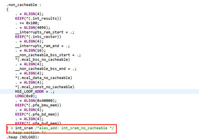

    Request: In serial boot, we want to run M7 APP in the SRAM.
    Platform: S32G274ARDB2.
    Prepare:

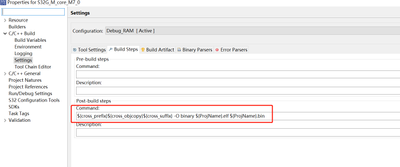

  • An uart1 application project was created using the S32DS. Select build mode as 'Debug_RAM'. To produce binaries, the 'C/C++ Build -> Settings -> Build Steps' have been modified:
  • In order for the program to run in SRAM, the link file 'linker_ram.ld' was modified.
  • In order to run in serial boot, the file header is added:

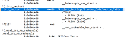

            (Reference '.map' file:RAM entry pointer = int_sram; RAM start pointer =
.intc_vector)
  • The final '.bin' file format is as follows:
  • Use 'S32FlashTool' to burn.
Issue:The program did not start, uart1 did not print.

For binary creation, we can recommend following the steps shown under the thread below:
HOWTO: Generate S-Record/Intel HEX/Binary file - NXP Community
As for the linker modification, we understand that this is not required for Serial Boot from UART interface. The examples should work out-of-the-box without this modification. We can recommend looking into the following threads that talk about serial mode booting:
Solved: How to create an image for serial boot? - NXP Community
Solved: How to boot an image from uart? - NXP Community
Where the first thread talks about creating the serial boot mode image and the second thread talks about copying into the SRAM inside the S32G platform.
Please, let us know.

Alex_mjl
Hi Daniel,
Thank you for your help! Its worked.
