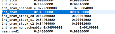

    Request: In serial boot, we want to run M7 APP in the SRAM.
    Platform: S32G274ARDB2.
    Prepare:

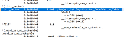

  • An uart1 application project was created using the S32DS. Select build mode as 'Debug_RAM'. To produce binaries, the 'C/C++ Build -> Settings -> Build Steps' have been modified:

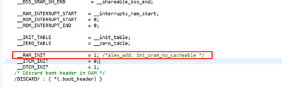

  • In order for the program to run in SRAM, the link file 'linker_ram.ld' was modified.

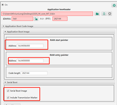

  • In order to run in serial boot, the file header is added:
            (Reference '.map' file:RAM entry pointer = int_sram; RAM start pointer =
.intc_vector)

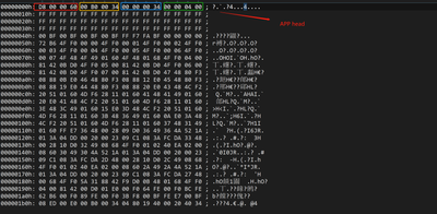

  • The final '.bin' file format is as follows:
  • Use 'S32FlashTool' to burn.
Issue:The program did not start, uart1 did not print.
