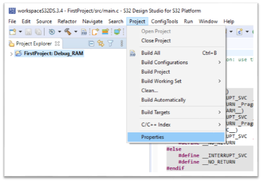

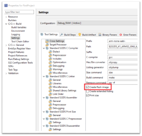

Right click on the Project name in Project Explorer -> Settings -> Cross Settings

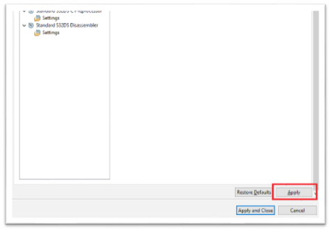

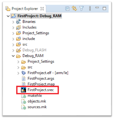

Be sure to click Apply so the 'Standard S32DS Create Flash Image' section will appear In the Tool Settings tab.

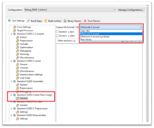

Select 'General' under 'Standard S32DS Create Flash Image', now you can specify output in newly appeared option Standard S32DS Create flash image

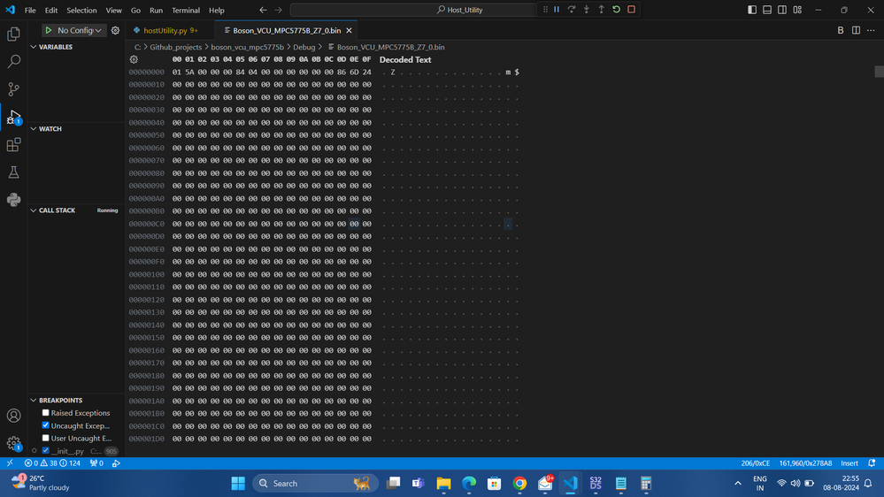

I followed your steps. To create the binary file for the bootloader using position indepenedent code. But my application is generating .srec file. Which I believe will not work with bootloader. So I tried to create .bin file using the raw binary option. And I tried to flash this file using bootloader. But it is not able to boot the application code after flashing the bin file to the S32K144 evb. Please help
