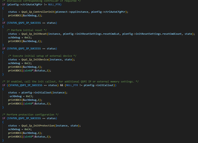

I implement UART module for debugging to see which init phase goes timeout and then I found the call stack like :
Fls_Init()-> Fls_IPW_Init() -> Fls_IPW_InitMemories() -> Qspi_Ip_Init
In the Qspi_Ip_InitProtection function,
this status is returned as timeout "STATUS_QSPI_IP_TIMEOUT"
--> Before the proceeding get and set protection phase on flash , it ensures that the previous command is completed.
Previous command is came from Qspi_Ip_InitDevice function.
I mean before the Qspi_Ip_InitProtection function, Qspi_Ip_ControllerInit function is called. There are lots of QSPI operation handled in this function. After that Qspı_Ip_InitProtection function is called and in this function it waits until the previous command is completed. But it is not. It goes timeout.
When I run the platform on SRAM, it is initialized properly. However when I try to run on FLASH, it is not.

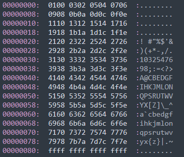

We are using the "Qspi_Ip_Example_S32G274A_M7" example which provides the following result (under SRAM):
It writes 128 bytes to the address 4096 decimal (0x1000) under the NOR Flash. We modified the example prior to flashing it to the S32G2-RDB2 platform, where the first value to be written is 2 instead of 0, then continue counting up (in other words, all values will have an offset of 2 decimal). Once we flash the example with this modification (using an IVT) we see the following outcome:
Which we correctly see the offset we provided to the example.
As a note, we obtain the Flash dump from S32 Flash Tool, we set the following range:
That is why the first address is 0x0 under our images.
In summary, we are not seeing the behavior you are seeing. As said in the beginning, are you using a provided example?
