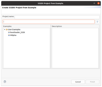

Can_Do_bus
Where exactly do you need to change the path?  I have installed the design studio Version: 3.4
Build id: 201217 (Update 3) on Ubuntu 20.04, its an arduous task just to install the software, it needs around 5GB hard disk space and almost 2 hours to install.
After installation I have to install Oracle JDK or else it won't start.
After it started, it was again installing the SDK's which took another hour.
After this when I try to create a project from example, the examples are not there I only see these two
The pin configuration tool also complains processor not chosen, how to fix this?

It looks like SDK is not installed correctly, you should have seen the examples if otherwise. For first time setup, I would follow the manuals step by step and do everything on Windows (since it is the actual supported OS for the SDKs).
Nevertheless to answer your question what exactly I change to solve my problem,
under installation directory in folder "NXP/S32DS.3.4/eclipse/mcu_data/components ", there are data for generating code. These file names and their references in the .js files are written case insensitively. I have changed the ones I could catch manually, that has done the job.

Thank you for replying, it appears those examples are based on S32_SDK_RTM however only the Freemaster SDK is installed as the part of Design studio, can you please check whether you have the S32_SDK_RTM installed on your linux version. I have posted a separate thread just to get some official response.
I have a separate installation of Design Studio ARM 2.2 that has the examples installed correctly which has both freemaster SDK and S32SDK.
I was tempted to install this monster under the assumption that it will do the pin configurations etc on Linux.

Thanks for engaging, my issue is mainly to find those zip files, the SDK I found on NXP site was an exe and not a zip file. Do you have a link?
6,037件の閲覧回数
Can_Do_bus
I have managed to install, it was just hidden in the CDT plugins page. Took an hour to install for some reason. Now I have the latest  examples.
