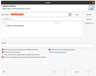

First issue is that "S32DS Extensions and Updates" window somehow do not show every package. S32G2 Development pack, GCC toolchains S32 Design Studio and Configuration Tools 3.4.1 package (comes with package manager bundle) are there, but other SDK packages did not appear after adding the update-site. I worked around this using Help/Install new software... section which let me install those packages.

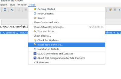

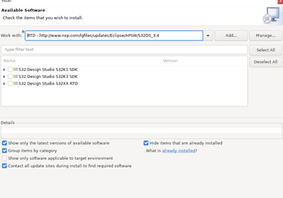

The problem of not being able to download the RTD SDK, I found the solution.
Instead of using the default S32DS Extensions and Updates... , use the authentic "install new software" function of eclipse
 Input this address, you'll find the sdk to download
http://www.nxp.com/lgfiles/updates/Eclipse/APSW/S32DS_3.4

Normally SDKs are installed through Extensions & Updates tool addressing update-site zip files as explained here. But as I mentioned in the post, in Linux, most packages do not appear (probably because they do not have official linux support) so I have installed them through "Install New Software..." section, addressing update-site zip archives. I always install and test them on Windows machine before installing on linux though.

Thanks for engaging, my issue is mainly to find those zip files, the SDK I found on NXP site was an exe and not a zip file. Do you have a link?
8,158 Views
Can_Do_bus
I have managed to install, it was just hidden in the CDT plugins page. Took an hour to install for some reason. Now I have the latest  examples.
